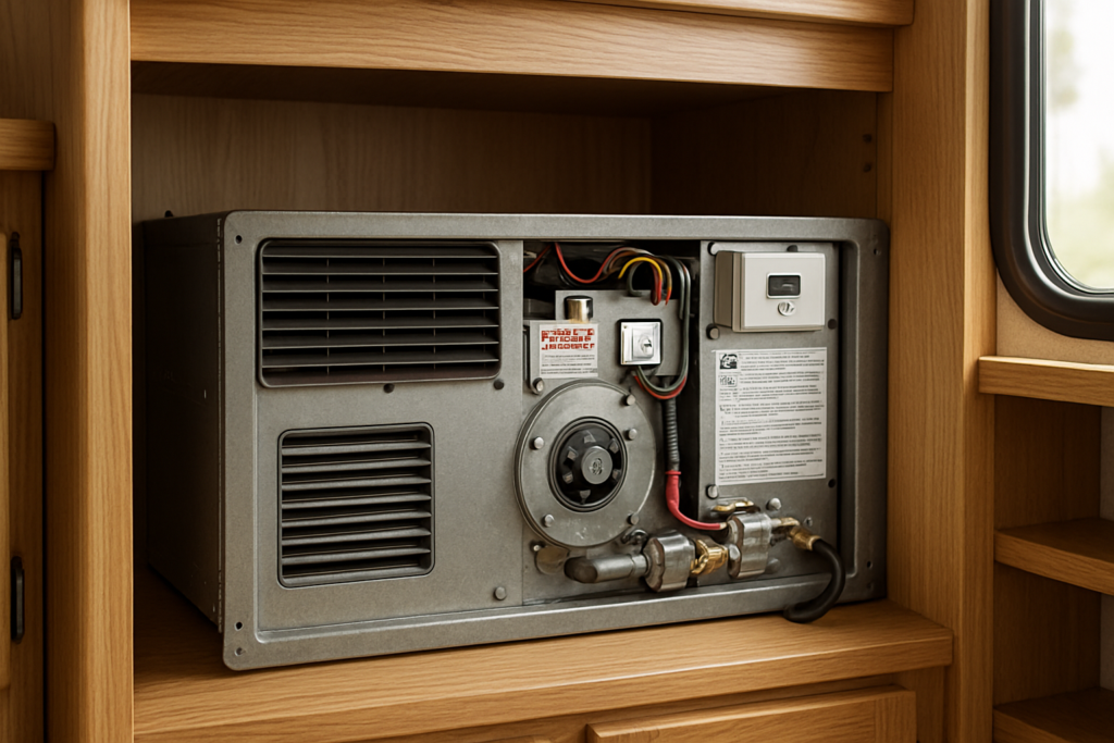

RV Furnace Basics: How It’s Supposed to Work
Before you start troubleshooting, it helps to understand how your RV furnace system works. Most RVs use a propane-powered furnace with a 12-volt electrical system that powers the blower and ignition controls. If either fuel or power is interrupted, your RV heater may fail to ignite or stop working altogether.
Here’s how the process typically works:
1. Thermostat Activation
When you adjust the thermostat, it signals the furnace to turn on. If the thermostat isn’t working correctly—or if its batteries are dead—your furnace might not respond at all.
2. Ignition and Blower Sequence
Once the furnace receives the signal, it checks for sufficient power and propane flow. If both are available, the blower fan kicks in first to circulate air and activate the sail switch, which then initiates the burner cycle with the igniter sparking to light the burner.
3. Safety Switches and Sensors
Your system includes components like the sail switch (which confirms proper airflow) and limit switch (which prevents overheating). If either switch detects a problem, the furnace may shut down as a safety precaution.
4. Fuel and Air Supply
A healthy propane supply and unobstructed vents are critical. Any issues with these can cause your RV furnace to blow cold air or fail to start altogether.
Understanding these parts and their roles will help you identify the root cause when your RV furnace isn’t working. Now that you know how it’s supposed to operate, let’s move on to a quick troubleshooting checklist to help you pinpoint the issue fast.
