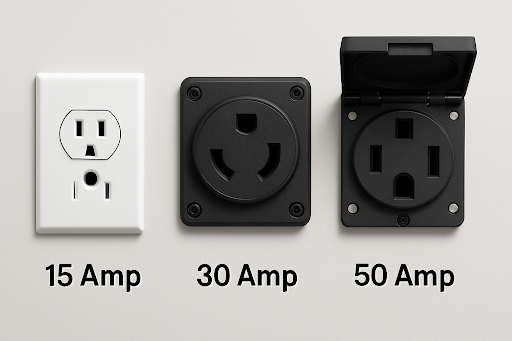

Common RV Plug Types Explained
Below, we’ll break down the most common RV and camper plug types you’ll encounter at campgrounds:
15-Amp Plug (Standard Household)
This is your basic three-prong household outlet (NEMA 5-15). Two flat blades plus a round ground pin. It delivers about 1,800 watts, which sounds like a lot until you try running an RV air conditioner.
Best for:
  • Small pop-up campers with minimal electrical needs
  • Emergency power when RV hookups aren’t available
  • Battery maintenance during storage
  • Ultra-light camping, where you’re mostly using propane
Expert Tip: While you can plug into a 15-amp outlet with the right adapter, be strategic about usage. Most RV appliances will quickly overwhelm this connection, so limit it to light loads like charging batteries, running a fan, or keeping the fridge cool.
30-Amp Plug (RV Standard)
The 30-amp plug features the distinctive NEMA TT-30 design with a curved hot blade, straight neutral blade, and U-shaped ground pin. You’ll find these at most campgrounds from Washington’s mountain parks to Florida’s beach resorts.
Best for:
  • Travel trailers from 20 to 35 feet
  • Class C motorhomes under 30 feet
  • Weekend campers and seasonal RVers
  • RVs with one air conditioning unit
Expert Tip: A 30-amp connection can handle an air conditioner, microwave, or electric water heater, but not all at once. Careful load management is key to avoiding tripped breakers and keeping your RV systems running smoothly.
50-Amp Plug (Premium Power)
If you’re running a big rig or living the full-time lifestyle, the 50-amp plug is your best friend. This NEMA 14-50 setup has four prongs: two hot wires, neutral, and ground.
Best for:
  • Class A motorhomes over 32 feet
  • Large fifth wheels with multiple slide-outs
  • Full-timers who want residential-style electrical convenience
Expert Tip: A 50-amp hookup delivers two 120-volt circuits, giving you true residential-style power. This setup allows you to run multiple high-demand appliances at the same time while keeping loads balanced across your RV.
Twist-Lock Plugs (Specialty Applications)
These plugs use NEMA L5-30 or L14-30 configurations and feature a unique locking mechanism. You insert the plug, then twist to secure it firmly in place, making them popular in setups where a tight connection is critical.
Best for:
  • Portable generators (great for boondocking)
  • Marine shore power at certain docks
  • Older campgrounds with specialized hookups
Expert Tip: Always confirm generator output before connecting. Some twist-lock generators supply 240 volts instead of the required 120 volts, which can instantly damage your RV’s electrical system.
